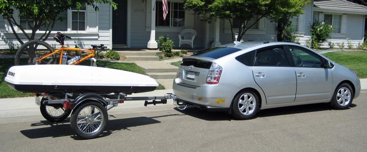

Prius trailer. :-)
Prius trailer
Prius trailer
